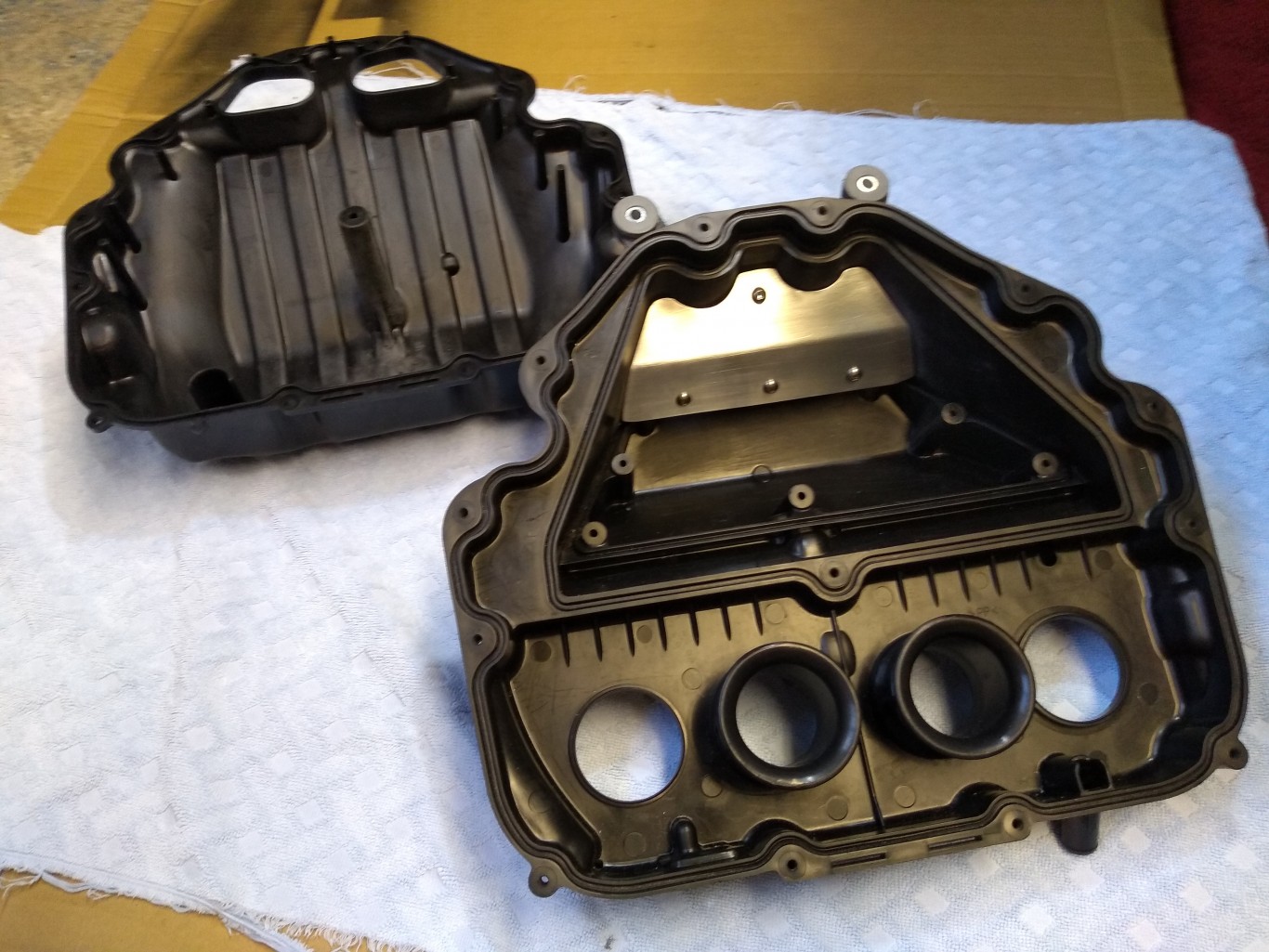

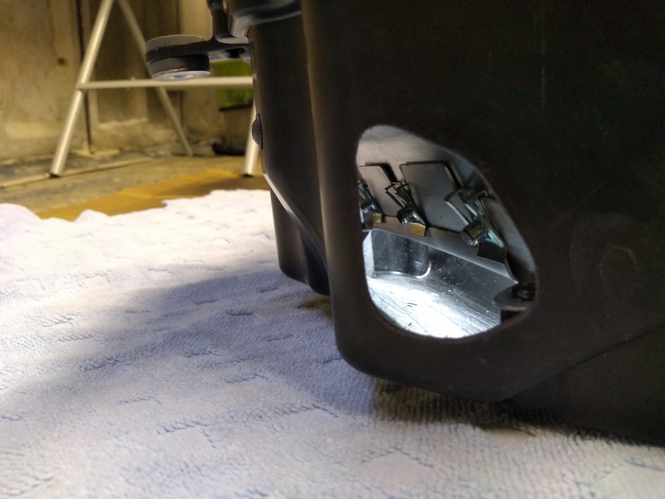

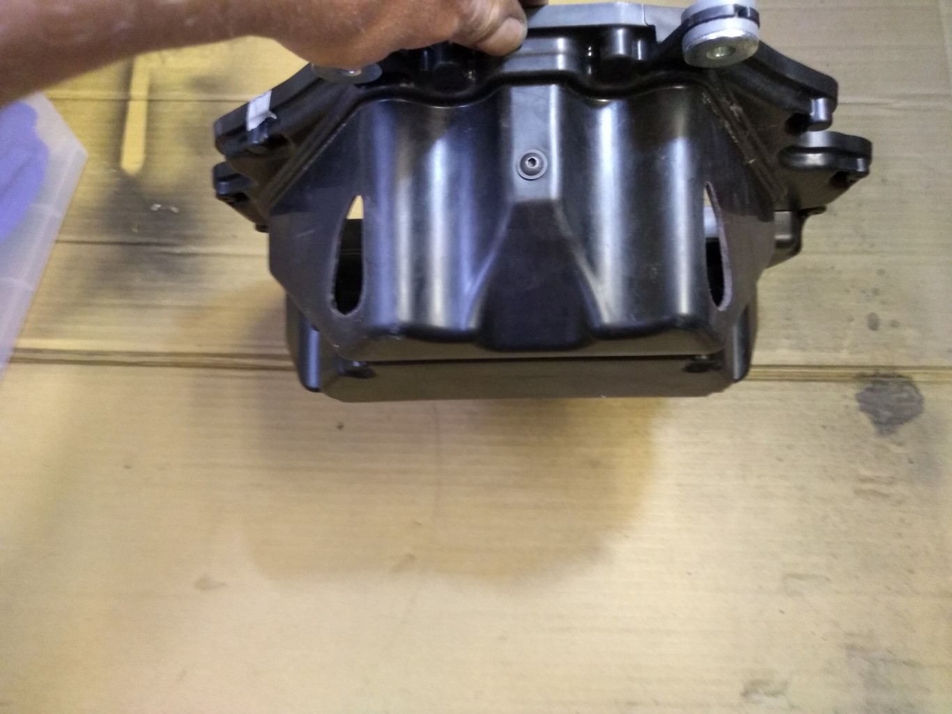

Being unable to ride during lock down I dedicated some time to modifying an eBay airbox.
Ivan's Performance increased the air box flow into a Z900RS with good results so thought I could do similar.
Ivan drilled 8x20mm holes in the 'RS airbox to achieve the increased surface area. The Z900 'box isn't the same and I wasn't convinced I could get the best results just drilling holes.

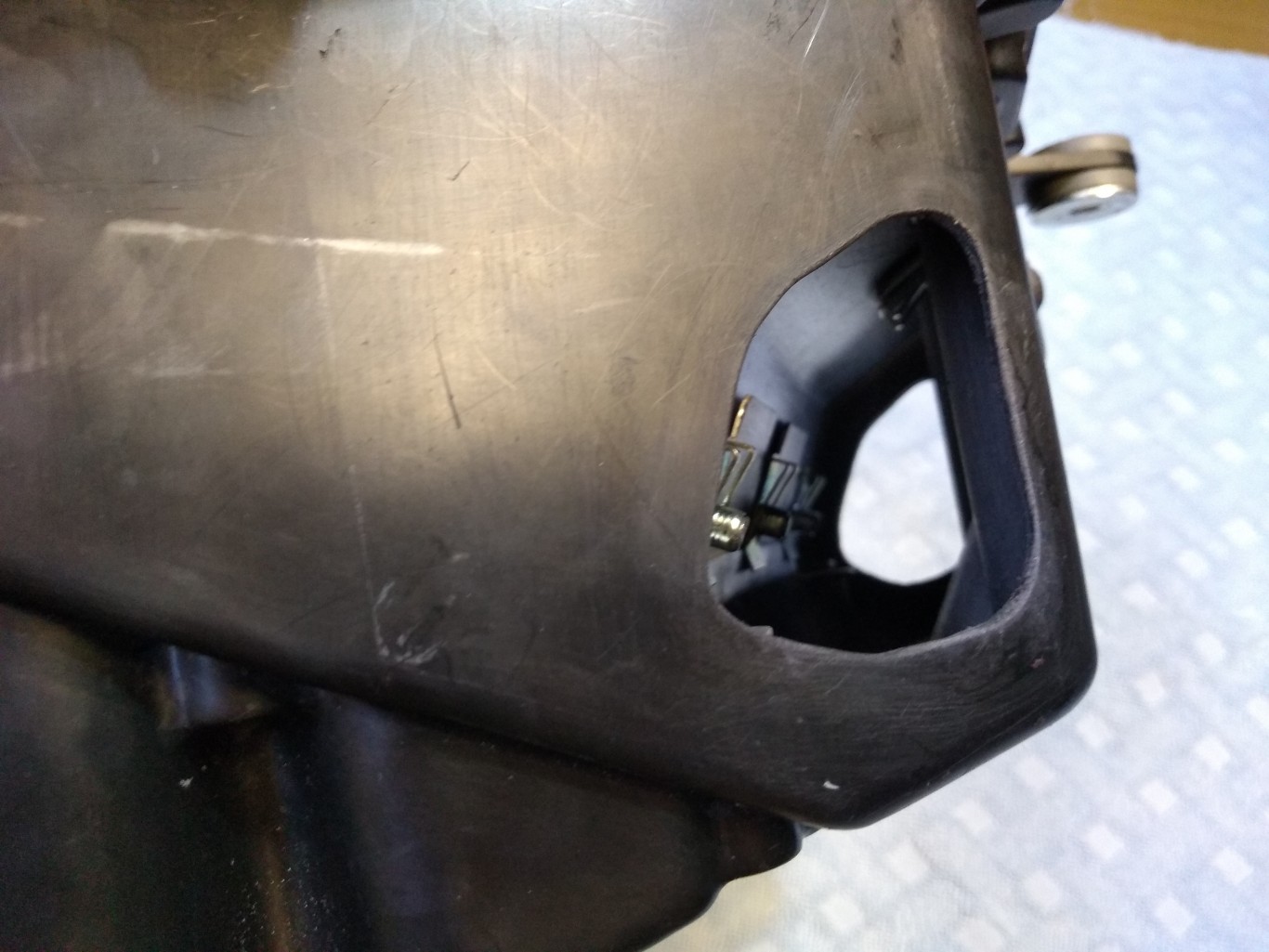

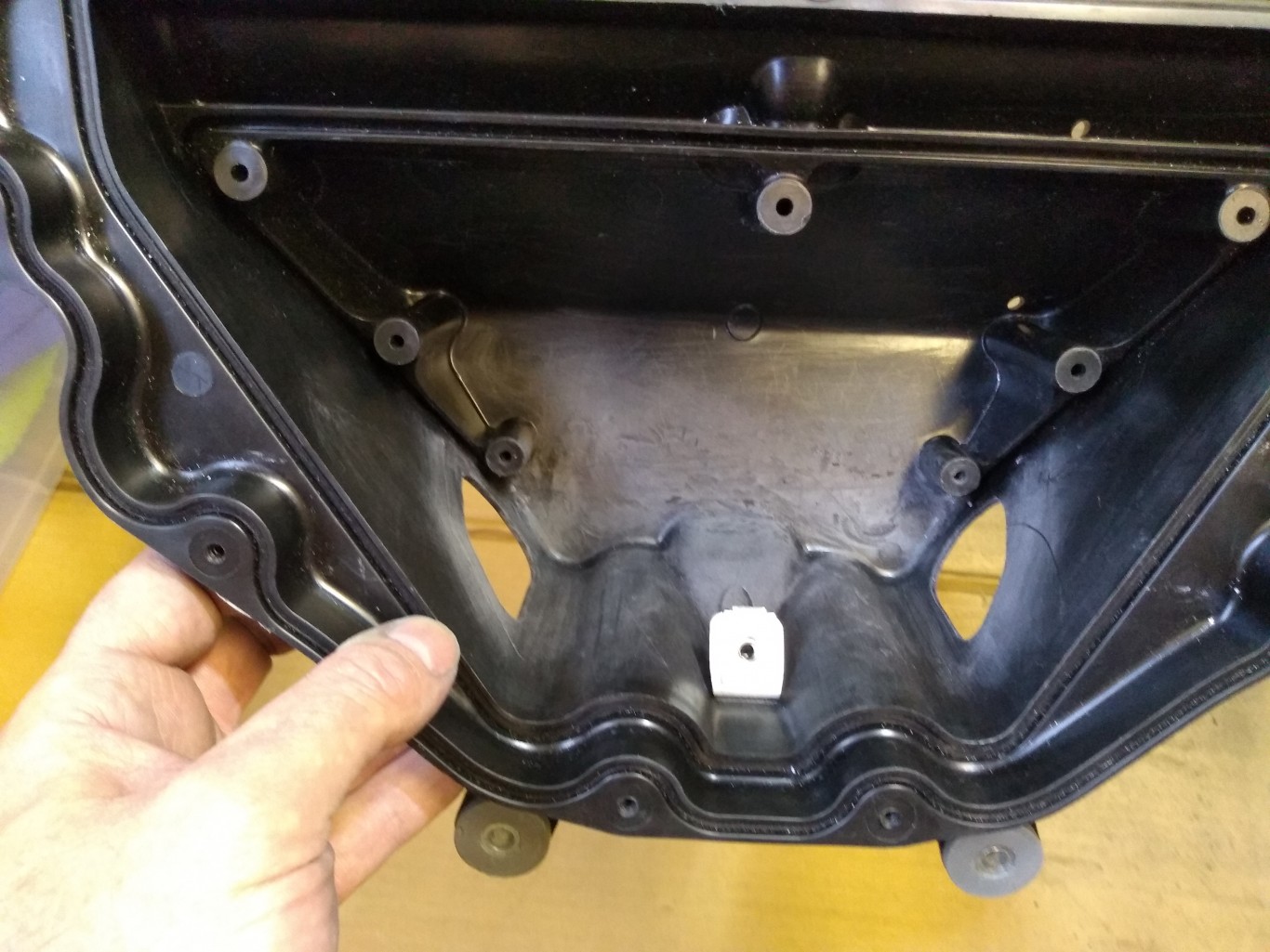

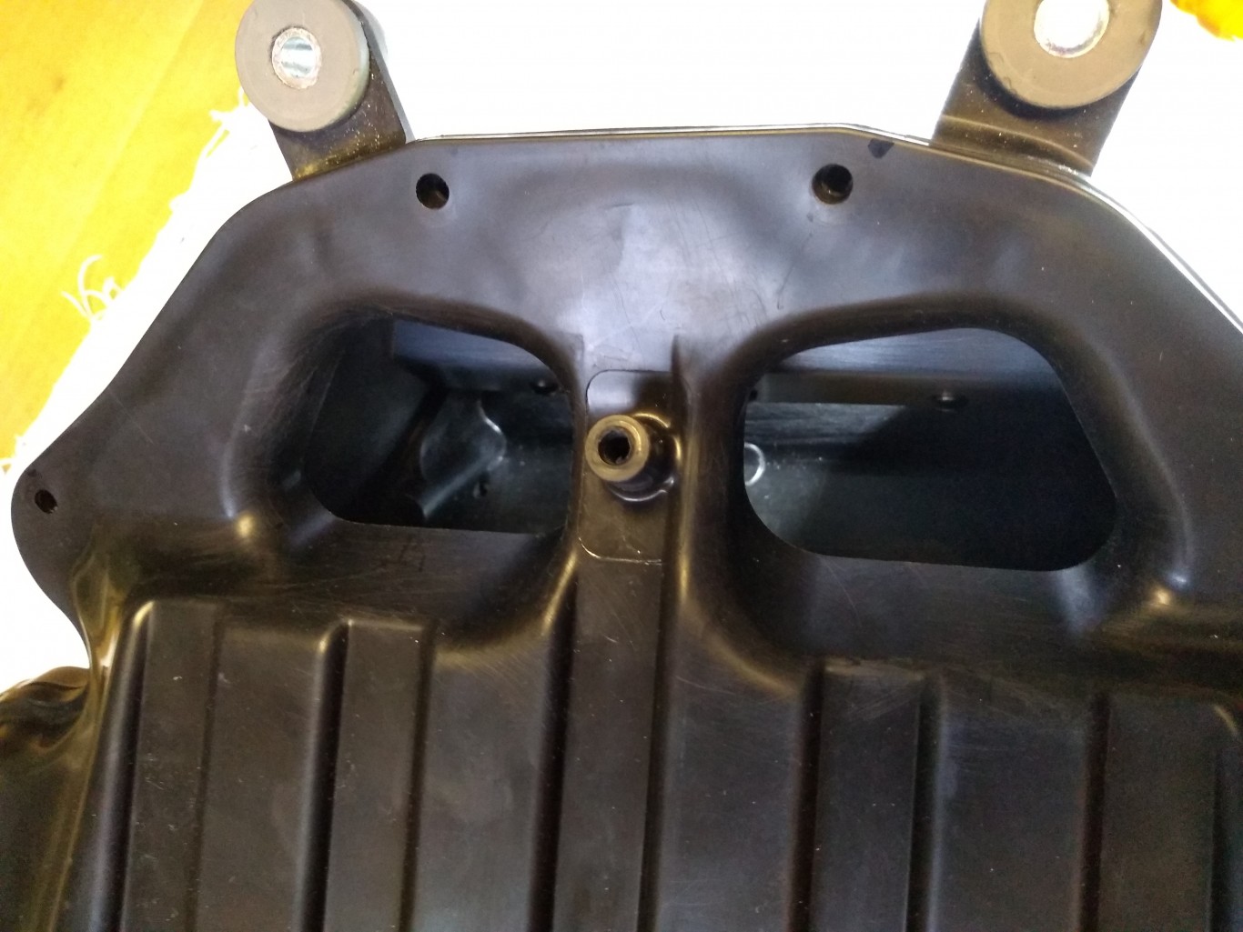

I wanted the additional inlets to be at the front because that is where there is the best chance of gathering cooler and cleaner air but because the Z900 air intakes are also at the front(/top) of the airbox I was concerned that adding inlets up front would interfere with the flow from the stock inlets.

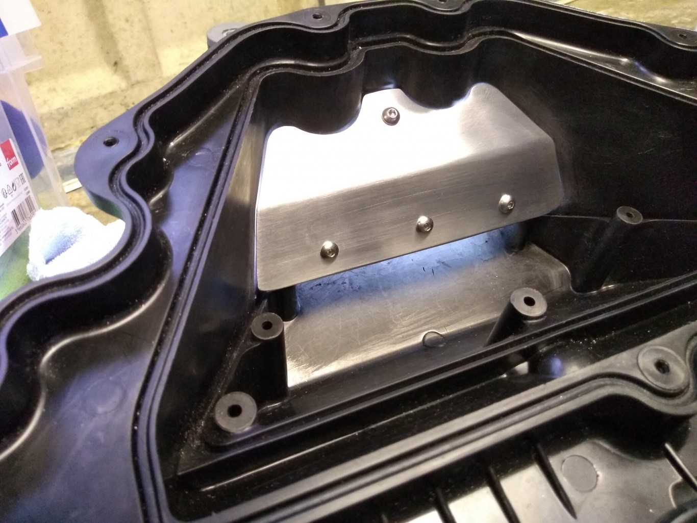

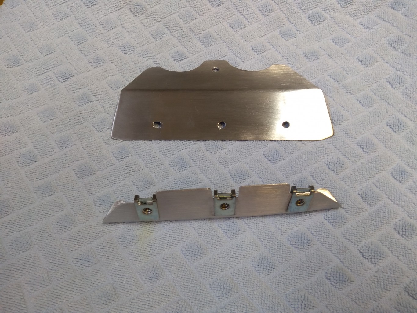

The aluminium deflector arrangement is intended to separate the original and additional intake streams, prevent interference and reduce turbulence, That's the theory anyway. :034:
Area of the additional inlets is about 20% greater than Ivan's 8 holes but that will drop when I add some mesh.
Will do some comparison tests after lock down and if the outcome is positive and it doesn't kill the the bottom end and mid range I'll get the bike dyno'd and flashed with the modified box.
I might be ace or it might be sh*te but total outlay so far is less than 50 with the added bonus that the airbox came with a filter element with less that 600 miles on it.  :821:

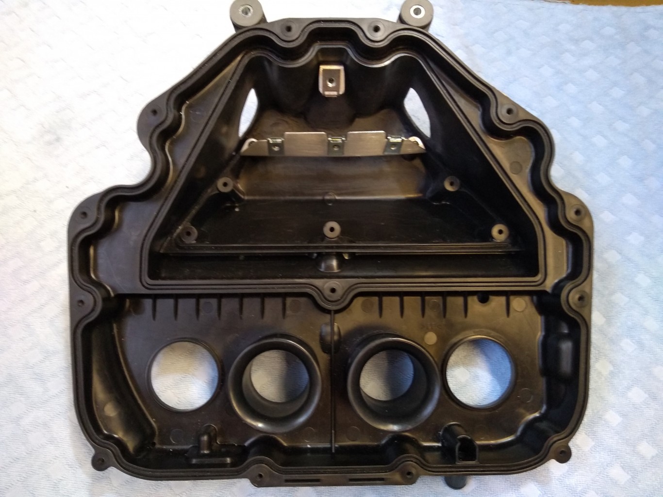

I also cut out the airbox lid divider and will run with the 4 short trumpets as Ivan did.
Pics below.

Be interested to hear the results. You think that just the 4 short trumpets would make much difference on their own without the additional inlets youve created?

I don't know. Possibly if the stock airbox flows well enough.  :027:
4 short stacks should favour top end power but only if there is enough air flow and fuel to match.
Ivan's dyno curves back that up but he also says that the 'RS benefited overall from running the 4 short stacks. I don't notice any significant losses lower down on his curves.
The "short" RS stacks look longer than the Z900 "short" stacks though. Another variable,  :034:

Good job. Very nice set up. The z900rs airbox mod doesn't work for well for the z900 airbox.
I was planning on getting a z900rs airbox's lid and modified the z900 lower similar to z1000 airbox. The opening will be about 19% bigger that OEM z900.
Let me know the result. I rather do your mod.

About 2 months ago I took a gamble that the z900rs velocity stacks sold on brocks performance may fit on the z900 airbox and have the same effect and as they were only about 30  seemed like there wasnt much downside either way. After installing it appeared to feel better higher up in the revs but that may just be me imagining it. Either way, it didnt have a negative impact and especially after I had it remapped just after, it did increase the sound from the airbox slightly and give a nicer intake sound.
