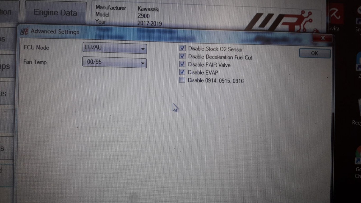

Offline JPZ900JP
  • Posts: 29
Re: Woolich - 2020 Z900
Reply #14 on: June 05, 2020, 01:29:12 PM
Offline MZ900
  • Posts: 864
  • Town / City: KLP
  • Country: lt
Reply #15 on: June 06, 2020, 08:50:41 AM
thats pretty interesting as i looked through the options list on woolich page: EVAP disable.  which is not on the list for 2017-2019 models
but my tuner did, tick this option for my bike
bike got Check Engine light On, after maybe few hours of tuning the bike on the dyno..... he was like..... emmmm that should disappear, his guess was its due front wheel standing still.... said : go for a ride and it will go off.....
 later he advised to go to Kawi dealer to check through the OEM diagnostics and maybe delete error, as his showed ZERO ERRORS...... when i arrived to Kawi, a guy said:  WTF IS THAT?? WHY EVAP disconnected?? reconnected EVAP plug back and error gone  :001:
