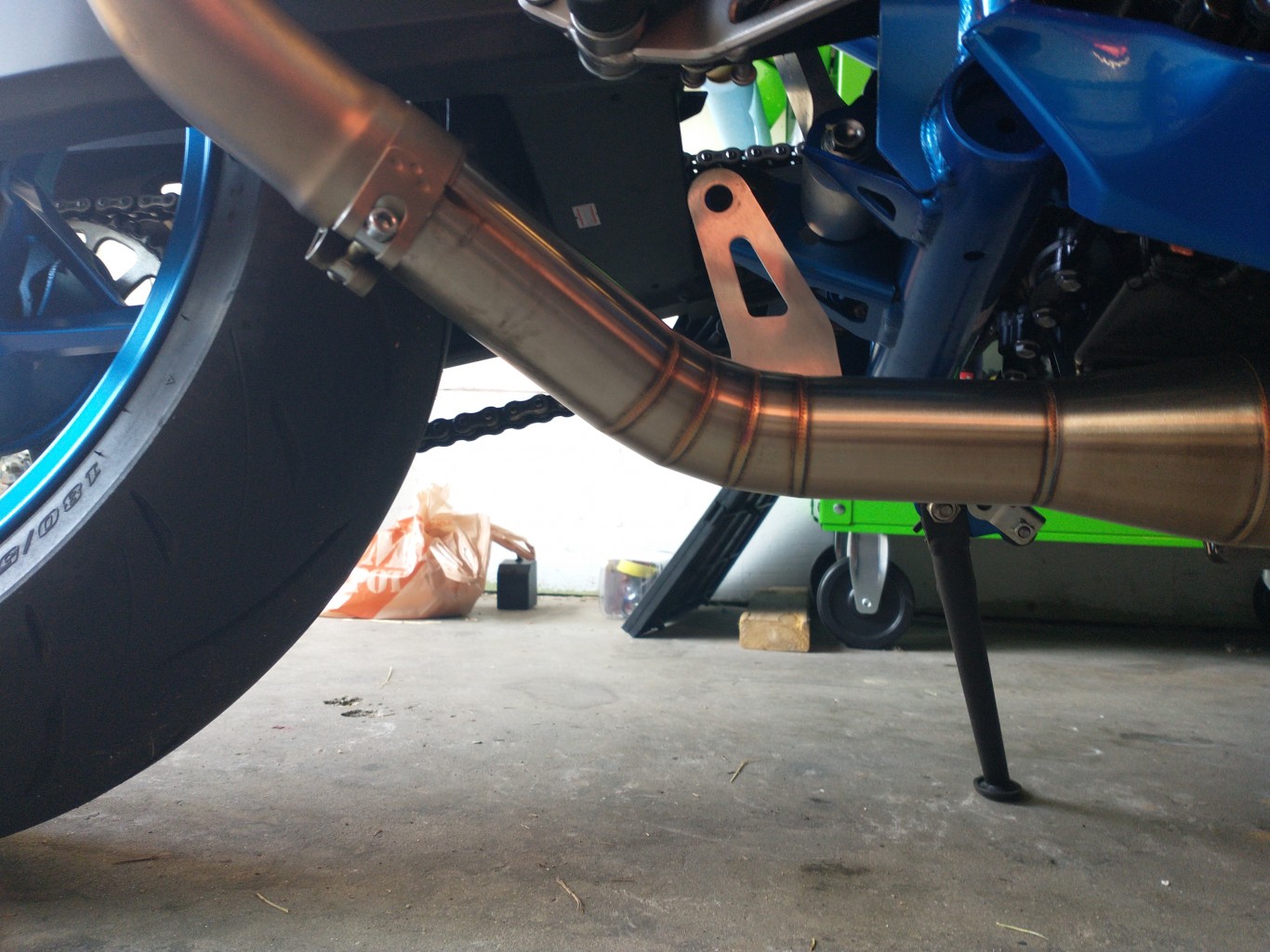

I've had my 2020 Z for about a month now. I bought it used with a little over 1k miles, and with a few mods done already by the previous owner. One of those mods was a cat delete + eBay midpipe. After a few miles, I've got some gripes with that setup ( as done by the old owner). This isn't to knock anyone who uses a midpipe, because I've seen better quality midpipes in use, better installs, etc.
The pros:
1. It sounds GREAT, especially in low RPMs, which is important to me as I do a lot of city driving.
The cons:
1. The midpipe, and really the whole setup, looks pretty rough.  The welds to bend the pipe are a quick giveaway that it's a cheesy eBay special, and none of the stainless matches (between the original header portion, the midpipe, and the slip on).
2. The mounting bracket on the midpipe seems to be in the wrong spot, and I can't get it (try as I might) into a position where it would be able to bolt on to where the bread box previously was. It's sort of "fine" because you can't see it, except it's totally not fine because...
3. ...having that bit of pipe unsecured causes some big vibration/resonance between 6-8k rpm, which is a shame because that's right when the bike comes to life. I've test ridden 2020 Zs with full exhaust (Akra), and this doesn't seem to happen on a fully-secured, fully designed header pipe. This is "big vibration" coming from someone whose garage includes a 1st gen KLR 650.
As much of a sacrilege as it is to step back, I'm considering picking up second hand OEM headers to run for the time being until I can justify aftermarket headers + a bench tuning setup to the wife. At this point I'd prefer the cleaner look, lack of vibration, and it wouldn't hurt to have that stock pipe on hand in case work brings us out to CA.
This is more of a vent than anything, but I'm definitely open to any suggestions on how to improve things.

It's either the original owner cut the OEM pipe in the wrong spot or is using a link pipe meant for a Z900RS.
At this point, looking to buy an OEM (used) header seems crazy. Just buy a better link pipe or chinese full header.
BTW: I'm running a full Akra with only 1 bracket...no vibration.

 Can't you just get a man with a MIG to weld a hanger bracket on in the right place?  :027:
