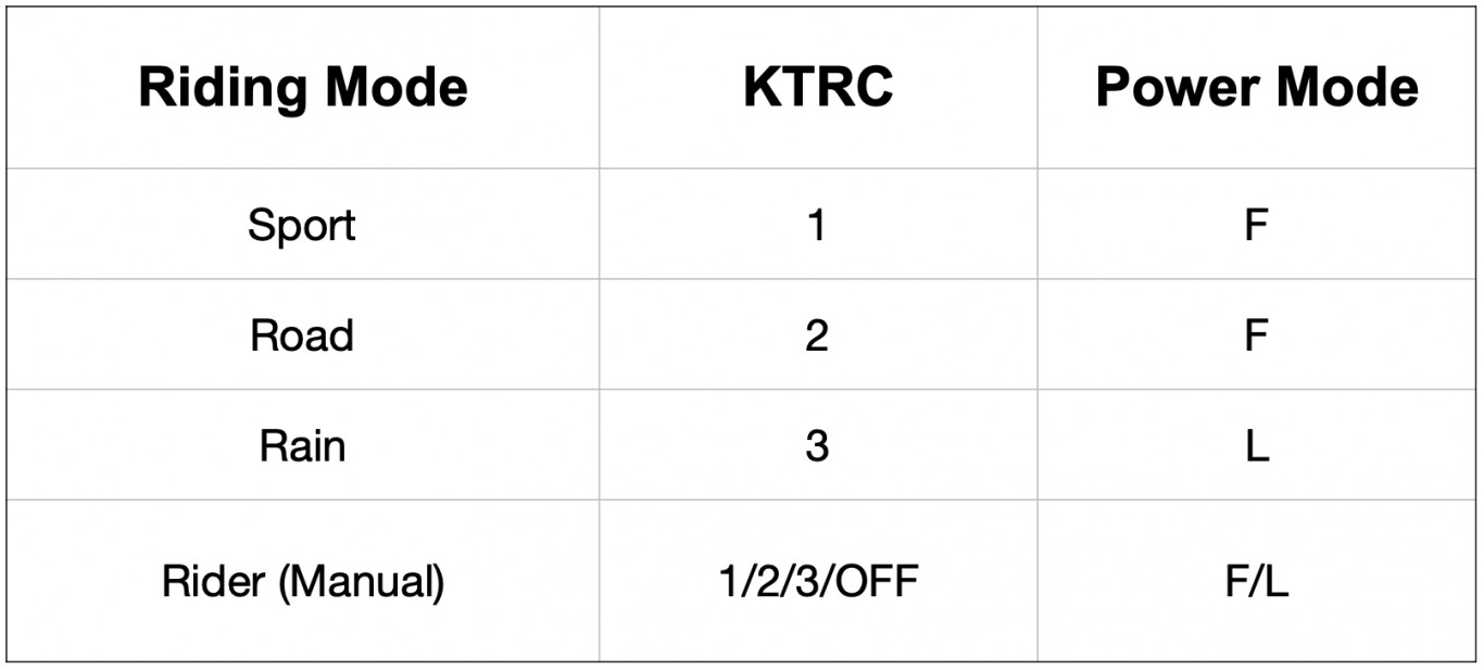

  • Offline Taibhse   pl
    • Z900 Member  ‐    45
      #7
    Offline Taibhse
    • Posts: 45
    • Bike: Z900 ABS 2023
    • Town / City: Wroclaw
    • Country: pl
    Re: ECU Flash effect on rider modes?
    Reply #7 on: Sep 11, 2023, 12.49 pm
    *Originally Posted by thefrisbee995 [+]
    Rain - fuel cut and full traction control
    Road - standard fuel and full traction control
    Sport - standard fuel and full traction control
    Rider - rider defined fuel and traction
    That’s what dealership told me
    I use my flashed sport mode for daily riding, then rain in the rain. You can either get a new map put on each or specific ones according to the guys that dyno’d and flashed my ecu. If you only use road and rain, I’d probably just get the fuelling changed on the road mode.
    Best bet would be to give your chosen company for fuel maps and flashing a call and see what they reckon as they know best and will do a map based on what you use your bike for and what you want from it. My company I chose to do it had to buy the newer connectors to do it as the 2020+ models use a newer connection to the ECU.
    Goes more like this:
  • Offline JP Tulo   us
    • Z900 Member  ‐    25
      #8
    Offline JP Tulo
    • Bike: Z900 ABS
    • Town / City: Ohio
    Reply #8 on: Sep 11, 2023, 06.43 pm
    *Originally Posted by Taibhse [+]
    Yeah this is more accurate. That table is straight out of the owners manual. It wouldn’t make sense that Sport and Road have the same settings like the previous poster posted.
