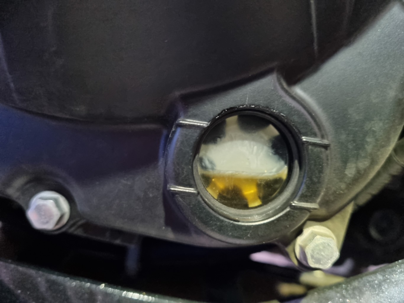

    Ok, so this is mostly aimed at riders in the UK or other notoriously wet regions of the world.
    I just performed an oil change at 6000km's. The oil that came out what dark and devoid of any water or other contaminants (aside from whatever usually makes it go dark over time).
    After I replaced the oil/filter and started the bike up this is what I saw in the sight glass.
    For reference, it is 14C here and the humidity is 92%. Pretty cold and wet by my regions standard.
    I suspect condensation after uncorking a warm bike with this kind of humidity but in all the years I've been doing oil changes I have never seen anything like this.
    Cheers

     As you say it's probably just condensation in which case it will evaporate when the engine has been run at full temp for a little while. Definitely something to keep an eye on though.  :821:

    ...just condensation in which case it will evaporate when the engine has been run at full temp for a little while
    That
    Agreed
