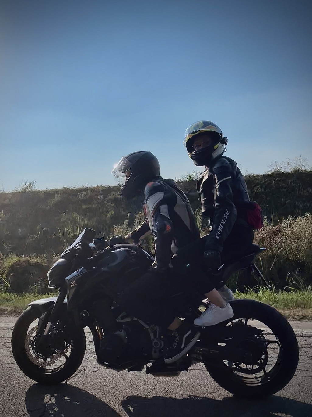

    I'll leave here some random pics of my bike.

    I’m just curious where you got that small woman that actually fits on the back? 👍

    I think she's pretty average, something similar to 1.60m tall and 60kg more or less. But before the Z I owned a KTM 950 Supermoto, so I think that the key here is that if you get her on an a super uncomfortable bike then an uncomfortable bike feels just as an upgrade anyway  :008:
    But she's just hardcore, I also have in the family a R1200GS owned by my father and she just hate it as she doesn't feel engaged in the ride. So yeah, I was happy to make an 11 days on the Z but also from her side it was the way to go. I would never do what she does.
